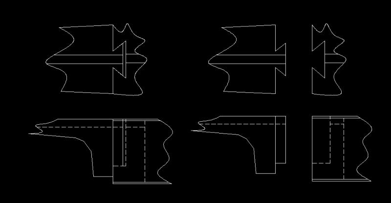

I an assuming that you have cut the mortise opening in the top of the guitar, or you would not be able to insert the tenon into the mortise, as the tenon and mortise are a progressive wedge shape in two differnt planes, the neck must enter from the top of the mortise. you can not insert the tenon from the end of the mortise you must insert from the top.MichaelP38790.6914930556
PostPosted: Tue Mar 14, 2006 9:43 am
I don't know if this any help other than showing why the dovetail tenon must enter the mortise pocket from the top of the mortise. you must have an opening in the top for both the tenon and the truss rod nut if the truss rod is a sound hole adjuster, and the tenon if a peghead adjuster. The cheeks of the tenon and mortise form the locking mechanism wedging the neck heal aginst the body.
